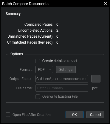

- Review the Summary information provided, which includes the pages that were compared, the number of differences found, and the name of the comparison document that was created for each page pair.
- To generate a report of the Summary information, follow these steps:
- Select Create detailed report.
- Choose PDF or CSV under Format.
- To change the folder in which the report will be saved, select the
button to the right of Output Folder and select the desired folder. - Enter a name for the report in the File name field.
- To overwrite an existing file with the same name in the selected folder, select Overwrite Existing File.
- To open the file once it's been created, select Open File After Creation.
Select Settings to set additional reporting options. The options available vary depending on what kind of report is being generated:
PDF
- Create Hyperlinks: When enabled, the report includes hyperlinks to the current, revised, and unmatched pages, and to the marked up PDF that highlights the differences between them.
- Stamp Date and Stamp Time: When enabled, adds that information to the footer of the report.
- Page Size and Orientation: Sets the page size and orientation of the report.
CSV
- Create Hyperlinks: When enabled, the report includes hyperlinks to the current, revised, and unmatched pages.
- Include Column Headers: When enabled, the file includes automatically generated column headers in the comparison report.
- Click OK.
