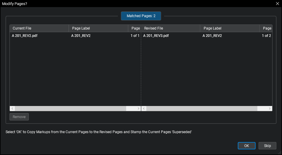

If Revu detects that the Set contains any revisions, the Modify Pages? dialog will appear.
Pages that have been automatically matched are shown on the Matched Pages tab, arranged in matched pairs: pages in the same row are considered "paired" and will be compared. Do the following:
- To move a page to a different row (and pair it with a different page), select it and use the associated
and
buttons. - To remove a page from either list, select it and select
. - To slip sheet the matched pages, copying the markups from the current pages to the revised pages and stamping the current pages as having been superseded, select OK.
- To not slip sheet the pages shown, select Skip.
The set is built and shown on the Sets tab.
and
and
