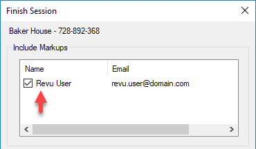

From the <Session Name & ID menu>, select
Finish Session. The Finish Session dialog box appears.
- To include markups made by specific attendees, select their names in the
Include Markups list.
Any markups included on a Session PDF can’t be altered once reuploaded to a new Session.
