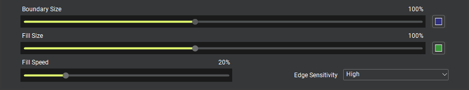

Default preferences for the Dynamic Fill tool reside in the Measure Preferences. You can also temporarily adjust these by selecting Dynamic Fill Settings on the Dynamic Fill toolbar. These changes last only while the toolbar remains open.
- Boundary Size: Set the cursor size when adding a boundary..
- Boundary Color: Choose the color for temporary boundaries.
- Fill Size: Set the cursor size when filling a shape.
- Fill Color: Choose the color when filling a shape..
- Fill Speed: Adjust how quickly the highlight spreads throughout the shape.
- Edge Sensitivity: Adjust detection sensitivity for shape boundaries. Modify this if boundaries are missed or extra boundaries are detected, especially when drawn lines have varying weights.
