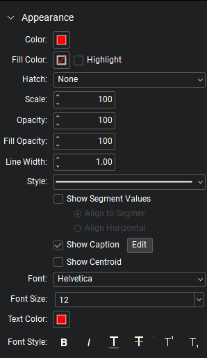

The appearance of the Volume measurement is configurable, including line and fill color, hatch pattern, line width and style, opacity, plus the font style of the caption and whether or not to show it.
To change the appearance of a Volume measurement, select the markup and select the Properties panel. Go to Window > Panels > Properties to show the Properties panel if it is hidden. Several properties will also be available on the Properties toolbar when the markup is selected.
Color: Sets the line color.
Fill Color: Sets a fill color.
Highlight: Makes the fill color and/or hatch pattern transparent so underlying content shows through.
Hatch: Sets a hatch pattern. The associated color selector sets the line color of the hatch pattern.
Scale: Sets the scale of the hatch pattern, from 50 (half the default scale) to 200 (twice the default scale).
Opacity: Sets opacity level of the line and endpoints, from 0 (invisible) to 100 (opaque).
Fill Opacity: Sets the fill and hatch pattern opacity, from 0 (invisible) to 100 (opaque).
Line Width: Sets the line thickness in points. A setting of 0 effectively renders the line invisible.
Style: Determines the line pattern. In addition, there are several advanced line styles and you can create Custom Line Styles.
Show Segment Values: Display segment lengths. Choose an alignment for these captions:
- Align to Segment: When selected, segment length captions will follow the segment line when it is rotated.
- Align Horizontally: When selected, segment length captions will always be horizontal, regardless of the markup's rotation.
Show Caption: Display caption text. Select Edit to choose which measurements to show.
Show Centroid: Display the geometric center. If necessary, the caption will be automatically adjusted to be below the centroid.
Font: Sets the font used for the selected text. Available fonts are divided into three regions:
- The first region shows all fonts used in the currently selected text element.
- The second region lists the standard PDF fonts that are supported by all PDF viewers. These fonts don't need to be embedded in the PDF when used, thereby cutting down on file size.
- The third region shows all other available fonts. When used, these fonts need to be embedded in the PDF.
Font settings are retained in the PDF and will substitute as needed if the original font is unavailable.
Font Size: Sets the font size for text. You can choose a size from 2 to 72 points in the list, or enter any value from 1 to 144 points manually. You can also use decimal values with one digit after the decimal point.
Text Color: Sets the color of text.
Font Style: Control the formatting of the text. Options include Bold, Italic, Underline, and Strikethrough. Generally, any combination of these styles can be applied to format the text.
