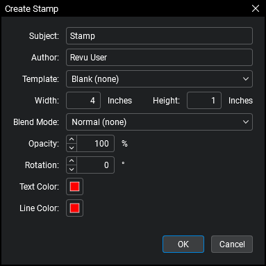

Go to Tools >
Stamp > Create Stamp.
- In the Subject field, type a descriptive name for the stamp. This name will appear in the Stamps list and in the Subject column of the Markups list.
- Change the Author name if you don't want to use your name.
- Select a Template from the dropdown. The options are:
- Blank: Nothing is added to the stamp.
- Text: Adds text found in the Subject field for the stamp.
- Text with Border: Adds text found in the Subject field and a square border to the stamp.
- Text with Date and Border: Adds text found in the Subject field, the Date and Time fields, and a square border to the stamp.
- Text with Rounded Border: Adds text found in the Subject field and a border with rounded corners to the stamp.
- Enter the Width and Height (in inches) of the stamp.
- Set any of the following Appearance properties:
- Opacity: Sets the opacity of the stamp as a percent, where 100% is completely opaque and 0% is completely transparent.
- Rotation: Sets the relative rotation of the stamp in degrees.
- Blend Mode: Defines the method by which the color in the stamp blends with the underlying PDF content.

- Text Color: Sets the default text color of the stamp.
- Line Color: Sets the default line color of the stamp.

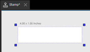

Select OK to open the stamp in edit mode.
You'll see a few things in a stamp that you won't see when editing a regular PDF.
- A stamp icon appears before the stamp name on the document tab.
- The width and height of the stamp is shown in the upper left corner of the stamp.
- A dashed blue line shows the boundary of the stamp on the page. You can resize the boundary by moving the square blue handles.
