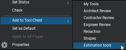

When you are satisfied with the results, right-click the markup and go to Add to Tool Chest > Estimation tools.

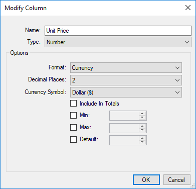

- Create a column to track the unit price of our materials. Enter a Name (for example, "Unit Price").
- From the Type list, select Number.
From the Format list, select Currency. It should look something like this:

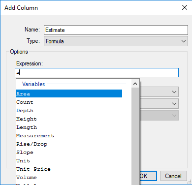

- Create a second column to calculate the estimated cost of materials. Enter a Name (for example, "Estimate").
- From the Type list, select Formula.

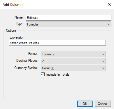

Define the formula for calculating the estimation as the area of the measurement times the price per unit. In the Expression field, start entering the name of the first Variable of your formula (in this case, you are starting with Area). When you start typing, a list appears with possible variables and the one that most closely matches what you have entered is selected by default. Select the Area variable.
Next to the first variable, enter the desired Operator. For this example, you are multiplying, so enter * (asterisk).

- Next to the Operator, enter the second Variable the same way you entered the first. Because you created the price capturing column first ("Unit Price"), it is listed as an available variable, so select it.
