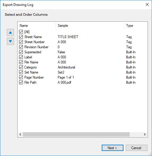

  4. Select the data you wish to include in the drawing log. Any Tags that have been added to the Set are shown as well as several built-in, default data elements.
  5. The data included in the drawing log will be in the order shown on this dialog box. To reorder a data element, select it and select Up or Down, as appropriate.
  6. Select Next to go to the second page of the Export Drawing Log wizard.

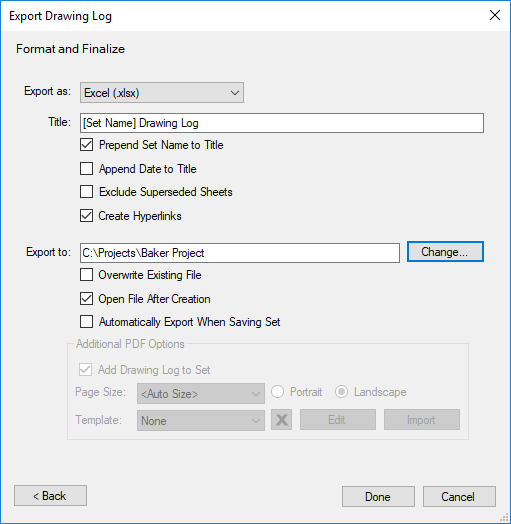

  7. Select a file type for the drawing log from the Export as dropdown menu.
  8. Set any of the following options, as desired:
    • Title: Enter the desired title of the drawing log. Some parts of the title can be dynamic if those options are selected; see below. These will be shown between brackets ( [ ] ) and altering them will automatically turn off the respective option.
    • Prepend Set Name to Title: When enabled, the name of the Set is automatically added to the beginning of the drawing log's title, as represented by the addition of [Set Name] to the Title field above.
    • Append Date to Title: When enabled, the date the drawing log was exported is automatically added to the end of the drawing log's title, as represented by the addition of [Date] to the Title field above.
    • Exclude Superseded Sheets: When enabled, sheets that have been superseded by later revisions are automatically excluded from the drawing log.
    • Create Hyperlinks: When enabled, hyperlinks to the sheets included in the drawing log are automatically created within the drawing log.
    • Export To: Enter the desired save location of the drawing log or select Change and choose the save location.
    • Overwrite Existing File: When enabled, the exported drawing log will automatically overwrite an existing file of the same name in the same save location.
    • Open File After Creation: When enabled, the drawing log will automatically open once it has been successfully exported.
    • Automatically Export When Saving Set: When enabled, a new drawing log will be automatically exported to the default save location whenever the Set is saved.
    If PDF is selected as the export type, an extra option is available:
    • Add Drawing Log to Set: When enabled, the drawing log is automatically added to the Set. Select a Page Size, orientation (Portrait or Landscape) as well as a Template for the page, if desired. Templates can also be imported by selecting Import.
  9. Select Done to export the drawing log.
