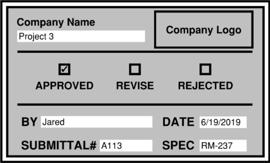

Place the stamp on a PDF
  1. Select Tools > Stamp and choose Submittal_Status.pdf from the list of stamps.
  2. Click-and-drag the stamp on your PDF. You should be prompted to fill out following fields:
    1. Select a Status.
    2. Fill out the Submittal # and Spec # if available.
  3. Select OK to place the stamp onto the page.
The content entered in the Stamp Dialog can't be changed after a stamp is placed on a PDF.

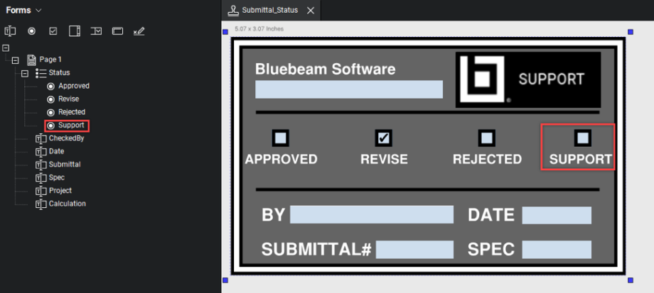

Edit a radio group
To add a new radio button to an existing radio group:
  1. Select Tools > Stamp, hover your cursor on a stamp file, and select the edit icon that appears on the right.
  2. Open the Forms panel.
  3. Select one of the radio buttons in the radio group Status (ex., Approved, Rejected, or Revise). This will highlight the radio button in the stamp.
  4. In the stamp, right-click the selected radio button and select Copy.
  5. Paste the radio button where you'd like it on the stamp.
  6. In the Forms panel, double-click the new radio button to rename it. For this example, a radio button was added and renamed Support.
  1. Select Tools > Form > JavaScript.
  2. Choose StampCode and select Edit.
  3. Add a new value to the radioGroup by adding a comma and a new line after the previous status's curly bracket.
    The new section of code looks like this:
    Copy
    { value:"Approved", description:"Approved" },
    { value:"Revise", description:"Revise" },
    { value:"Rejected", description:"Rejected" },
    { value:"Support", description:"Supported" }
  4. Select OK to exit the JavaScript Editor.
  5. Select OK to exit the Global JavaScript dialog.
  6. Save the stamp PDF and test your changes.
When you add the updated interactive stamp to a PDF, the Stamp Dialog should display the new option created. In this instance, the dialog now shows a fourth radio button called Support.
