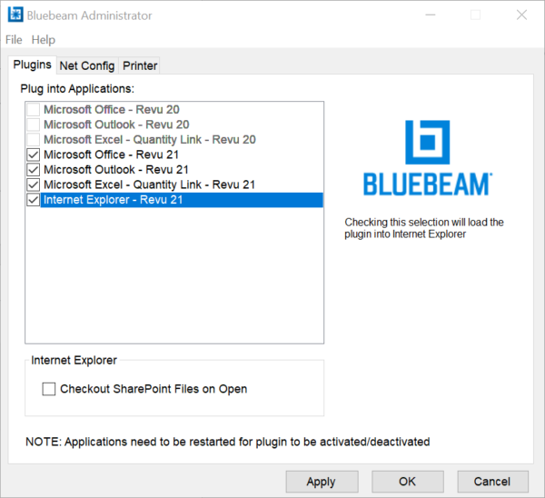

Enable plugins in the Bluebeam Administrator
  1. Open Revu. If you're using Revu 21, sign in when prompted or select Sign In.
  2. Select Revu > Administrator.
  3. On the Plugins tab, select the integrations you'd like to enable.
    Bluebeam Administrator Plugins tab
  4. Select Apply or OK to activate the plugin.
    If the third-party application is open, close and reopen it. The Bluebeam toolbar/menu/ribbon should appear now.
To reset a plugin, deselect the application in the Bluebeam Administrator and apply the changes. Then, reselect the application and select Apply or OK.
