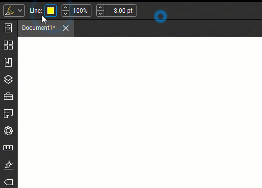

Create your own CVD-friendly color palette in Revu
Reach out to your organization to see if they already have inclusive color palette guidelines. If they don't, it's easy to create your own custom color palettes in Revu. You can search the web for inclusive color palettes that are vetted by people who have CVD. In many cases, these palettes will include hexadecimal color codes (also known as hex codes), so you can replicate them in software like Revu.
create color palette in Revu 20
Create a custom palette with hex codes
Once you've found the hex codes for an inclusive color palette, here's how you can recreate the colors in Revu.
  1. Select a markup that can be customized for color, such as the Highlighter (H) tool.
  2. Go to Line Color in the properties toolbar, and select the down arrow to see advanced preferences.
  3. Paste a hex code into the text block with the number (#) sign.
  4. Select Add.
The color will appear in your Revu color palette and can be applied to other markups.
