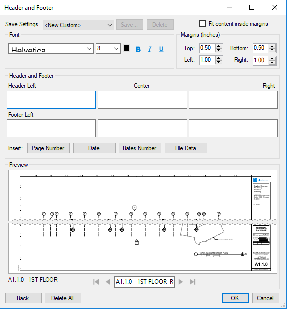

There are six boxes in the Header and Footer section representing the right, left and center areas of the header and footer, respectively. To populate these fields with a previously configured header/footer template, select it from the Save Settings list. Otherwise, add information to any of these by selecting the desired box and entering text or selecting one of the Insert buttons, which are described below.
- Page Number: Auto-generates a page number value in the chosen format.

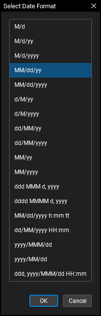

- Date: Auto-generates the date in the chosen format.
- Bates Number: Auto-generates a Bates number with fixed number of digits and a user-defined prefix and suffix.

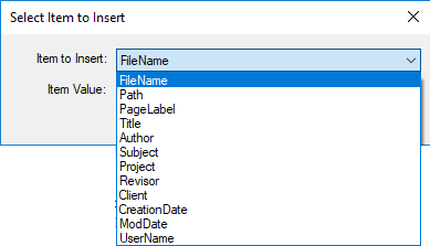

- File Data: Inserts a selected file property, such as the file name, document path, author, and more.
- Define the appearance of header and footer text using the Font controls at the top of the dialog.
- Adjust the Top, Bottom, Left, and Right margins by changing the Margins values.
- Margin settings are visible in the Preview section and update dynamically when changes are made.
- To shrink page content to fit within the margins, select Fit content inside margins.
- Use the Preview window to check that the header or footer does not cover any information already on any of the document's pages. Advance through the pages using the navigation controls below the preview window.

In the Header and Footer section, there are six boxes representing the right, left and center areas of the header and footer, respectively. Current header and footer content is shown in these boxes.
Edit any or all of this content by selecting the desired box and manually editing the text or by selecting one of the four Insert buttons:
- Select the desired Font settings to change the appearance of the header and footer text.
- Margin settings are visible in the Preview window and update dynamically when changes are made.
- Use the navigation controls under the Preview window to check that the header and footer do not overlap page content.
