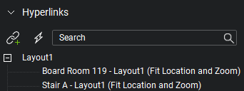

Any hyperlinks in a PDF are listed in the Hyperlinks section of the Links tab.
There are several actions available in the toolbar just above the list of hyperlinks:
Hyperlink: Creates and view hyperlinks in a PDF.
Edit Action: Brings up the Action dialog to define what happens when the link is selected.
Search bar: Filters the hyperlinks list by the text entered into the field. Useful for documents with a large number of links.
Select a hyperlink from the list to jump to it on the PDF. Hold Shift or Ctrl while selecting to select multiple hyperlinks.

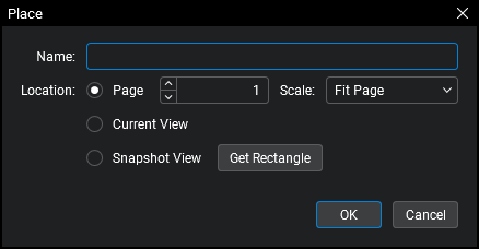

Hyperlinks can be created to Places in a PDF, which are defined and named anchors than can be placed anywhere on a document so that you can easily link to that location. Places can be moved on the PDF without breaking links to them, provided that their names remain unchanged.
To create a Place, follow these steps:
- Go to Window > Panels >
Links or press ALT+N to show the
Links panel. -
In the Places section of the Links panel, select
Add Place.
- Enter a name for this Place in the Name field.
Select one of the following options to describe the Location of the Place:
- Page: Use to define a page number in the PDF as the location, with option to define the scale.
- Current View: Sets the current page and scale as the location.
- Snapshot View: Use to define an area on the current page as the location. Once selected, select Get Rectangle and drag a rectangle over the desired area to set the view.
- Select OK.
