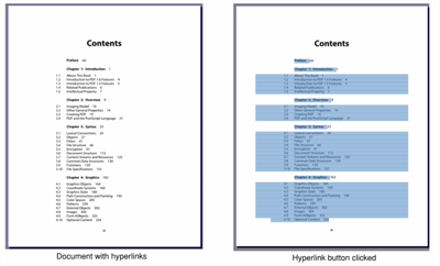

Go to Tools >
Hyperlink to view the hyperlinks in the current PDF. Hyperlinked areas of the PDF are highlighted in blue.
To turn off the Hyperlinks view, press Esc.
