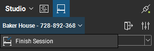

To finish a Session:
  1. Join the Session, and ensure no one else is currently active.
  2. From the <Session Name & ID menu>, select Finish Session.
    Select "Finish Session"
  3. To include markups made by specific attendees, select the desired names from the Include Markups list. Any markups included on a Session document will be unalterable once reuploaded to a new Session.
  4. Select Save In Folder to save the Session documents in a specified folder and preserve the original files from being overwritten. To change the default folder location, select and navigate to the desired folder. If needed, select Session Subfolder to create a subfolder with the Session name in the specified location.
  5. Select Close files after finishing to automatically close any Session files that are currently open in Revu.
  6. To generate a report for the Session, select Generate Report. To learn more about Session Report types and settings, see Generating a Session Report.
  7. Select OK to finish the Session.
The Session and all of its files are removed from the Studio server when the Session is finished. If you need to recover any Session documents, reactivate the Session within 120 days and then recover the desired Session document(s).

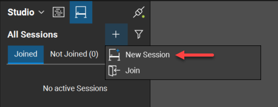

Once you've signed into your desired Studio server region:
  1. Create a new Session by selecting Add > New Session.
    Select Add > New Session
  2. Under Documents, select Add. Navigate to the folder location containing your Session documents, and select the desired documents.
  3. Configure your Session settings, and select OK.
A new Session that contains your desired documents opens. Invite users to the Session to begin collaborating.
