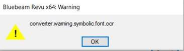

Error: "converter.warning.symbolic.font.ocr"
Applies to:
  • Revu 21
  • Revu 20
Problem
When using File > Export to convert a PDF into another file type (i.e., Word or Excel), you receive the following error message:
file conversion ocr error
Cause
This error is related to corrupt font issues.
Solutions
To troubleshoot, try one or both of the workarounds below.

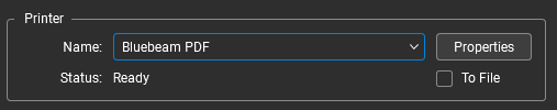

Bluebeam PDF Printer
  1. Select File > print Print.
  2. Under Printer, select Bluebeam PDF.
    printer name Bluebeam PDF
  3. Select Print.
  4. Choose where to save the new version of the PDF via the File Explorer.
  5. Select Save.
  6. After the new version of the PDF automatically opens in Revu, select File > exportExport and try the file conversion again.
