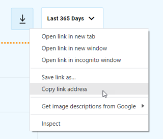

  5. With your cursor, hover over the Download button.
    Download Usage Report
  6. Right-click the Download button and select Copy link address.
    Copy Link Address
